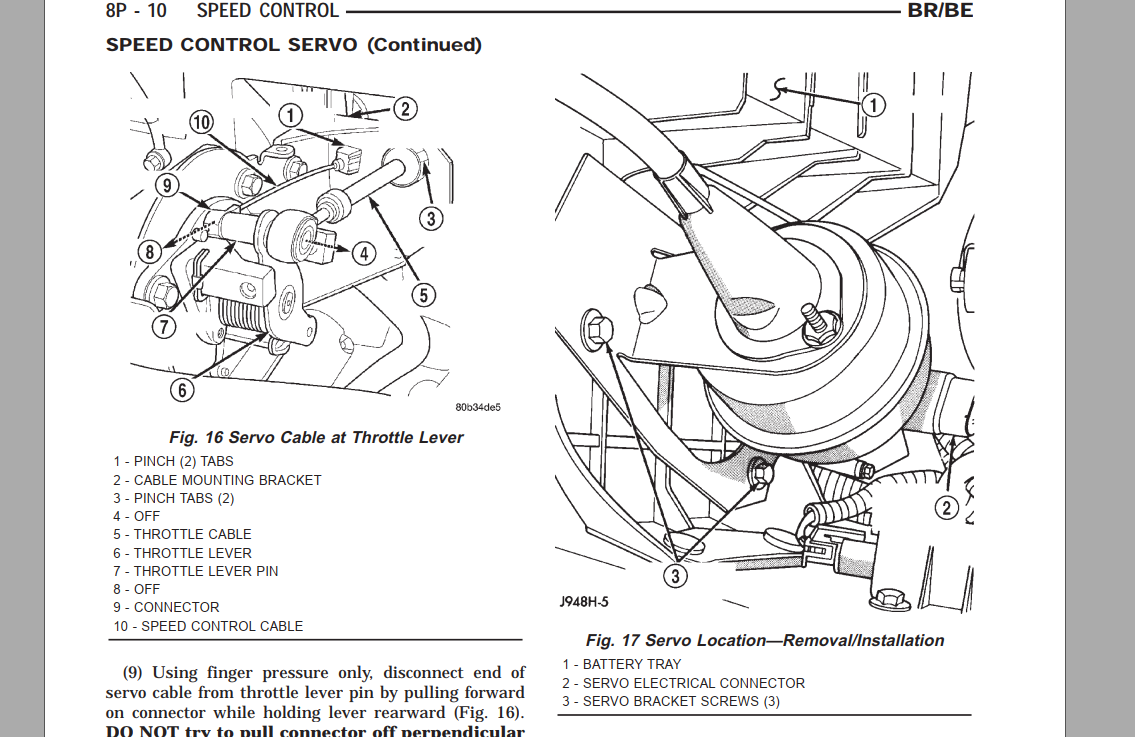

We had someone on here a little while back that had an 01 manual with a vacuum servo on it. I dont think we ever determined wherther the tranny had been changed.
@Jake B do you have a vacuum servo under the drivers battery?
I don't think I have that vacuum servo because I couldn't find any vac lines going anywhere under the battery tray. Also all the buttons work on the steering wheel. When the truck sets itself at 50, I can press the cruise button to turn it off or I can press the cancel button. One time I was driving and I had cruise set to 40, then the truck decided to set itself at 50 and I could fight the truck by pressing the coast button.

Stupid question what is running the throttle when cruise is on vacumn?

For an automatic,  The vacuum goes to a servo (providing the force) a cable comes from the servo to the throttle linkage at the APPS
