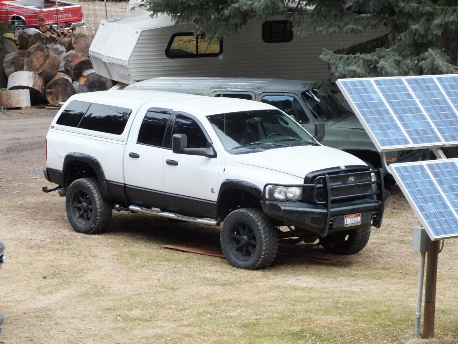

37x12.5x16.5 military tires on 2nd gen. Plus 03-12 upgrade steering
Actually bought these for the wheels so I can weld in jeep centers.
Will play with them on the pickup for a month or so while I round of parts to make them jeep wheels.
There h1 12 bolt bead locks.
I've got to remove the 40lbs of runflat from each wheel. These are heavy with the run flats in
Itl get old quickly running 37s but I figure maybe I'll play with them for a few just cause

07 steering is on.  We bought it new as a cab n chassis its actually 2wd but shares all front end stuff with my truck
Dad thinks its heavier duty than a normal 3500 im like no look at it its same everything as my 02.
I have a fox steering stabalizer laying around i may put it on the 07.
Also replaced all passenger side wheel studs they must have been loose all showed wear pattern at the base of the hub. Very thankful they are hub centric wheels

Get this right...  I'm a big advocate of PROPER GEARING. I can careless about how big you want tires but when people just throw tires on and their final ratio is ruined (less than 3.40) and they don't like the answers to fixing the improper gear ratio. Either change the axle gears or ditch the tires. Both are expensive. Everyone assumes you can just swap bigger on without any support mods either. Doesn't work that way...
Currently I've this 2005 Dodge with a blown steering box from 35 inch tires and no supporting mods either... People wonder why steering and suspension damage comes so quickly. :rolleyes: Steering box on its way to @Blue-Top Steering being rebuilt. Might take a 2 or 3 weeks to turn around.

This truck I slapped together in short time to go play had 2.5 ton duce axles with 6.72 ratio and 46" military tires that weren't light, but because of ratio I had no issues, just needed a front locker.
This truck had same axles but instead of 46" I used 52" had to build a bbc for that one to compensate, still top speed was slower than before I swapped the axles, I believe I was close to 2800 rpm at 70mph, yeah I drove it on hwys :burnout:my dream was to put a cummins in it. Life changed that. I don't have any regrets thought.
I don't mind poking the bear once in awhile but yeah the amount of truck I work on where the owner slaps on a set of 35 to 37 inch tires without supporting mods and support axle gearing it absolutely sickening. Day after day I try fixing these truck because they just wanna look cool. I'm the one replacing steering boxes, tie rod ends, track bars. Always for a customer rarely and I mean rarely for myself. Hmmm... Maybe I figure something out. Big tires suxs... 427k miles and still going...
