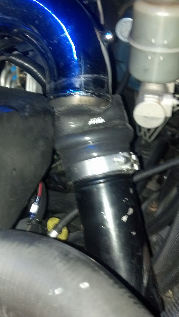

Got the new gauge in tonight.... turns out I was making 60psi until BOOM
Edited by TFaoro
Bummer! But at least you know what kind of boost your making instead of guessing off a bad gauge. Did you paint your intake horn?
No... those are under the hood LED's. It happened around 10:30pm on the highway.
7 hours ago, Mopar1973Man said:
Time for silicone boots and fresh clamps.
These are very thick boots. I haven't counted the plies but they are definitely thicker than the vulcan ones I have sitting in a box over here. Clamp was fine. I just cranked it down, hammered the hell out of it again and it didn't move!
care to part ways with your vulcan boots?
It's always exciting when something let's go at that high psi
If I had all of them I would....
