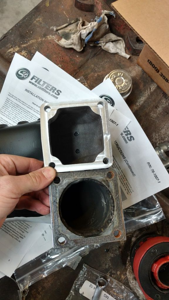

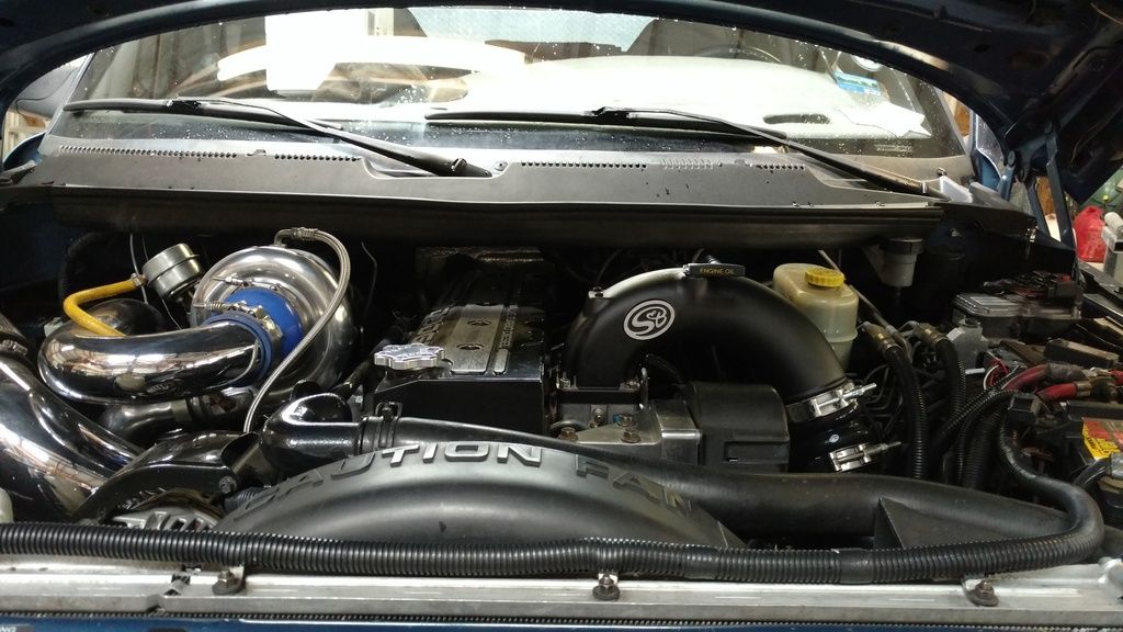

Finally made it home and got my intake horn installed. She's a beauty! 65psi just fine with no boots blowing off. I think I might be able to run a 1200us tune on the quad and have decent egts. I tried an 1800us and egts flew to 1700 before I let off. Here's a comparison of the outlet for those curious. The S&B is also 3.5" so I'm running the adapter boot provided.
