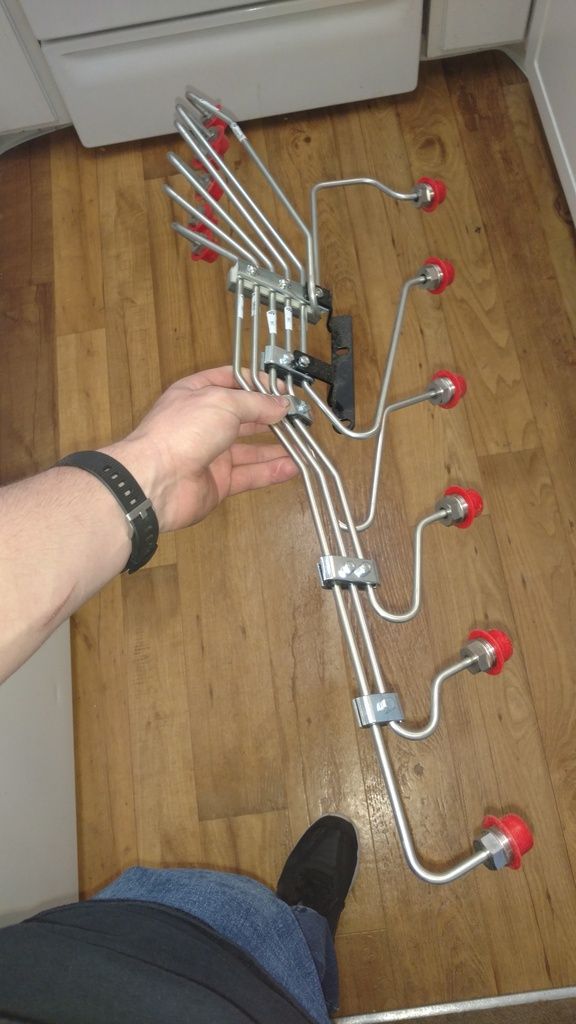

Add. More. Clamps.
You happen to know where to get clamps for a VP44? Pretty sure a couple of mine fell off  :(
7 hours ago, jlbayes said:
Add. More. Clamps.
You said where they will fit, but where would that be?? It looks like they put them in all the good spots. Only place I can see is the 5/6 lines closer to the pump.
@trreed might have some depending on what you need.
Any idea where to get some clamps for my lines @jlbayes?

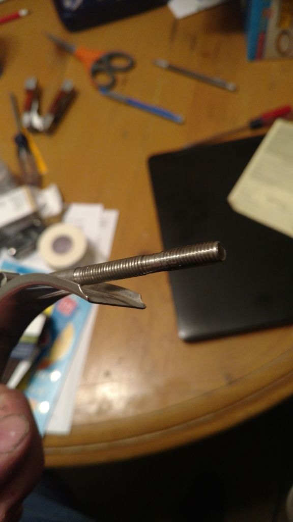

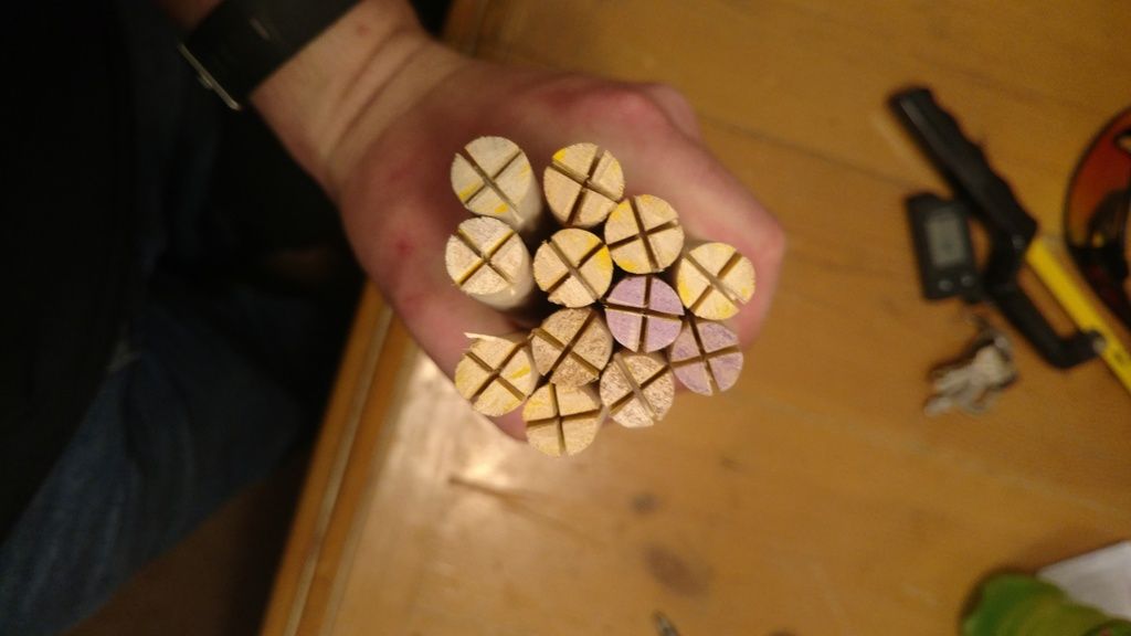

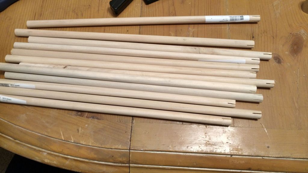

Got some work done tonight. I picked up a new T clamp from Central State Hose in Denver. I cut some 1/2in dowels to length, and split them at the ends. I will round the ends with the bench grinder when I get home. Most of the Crazy Carl kit should be at my parents place tomorrow. It'll be missing the throttle kit and the tunnel ram. They won't have tunnel rams until late next week, so I bought a grid heater delete to use as a spacer. I also bought a chunk of 3" exhaust pipe to use between the horn and the IC. I got 2 feet, so I'll cut it to length and weld some fat beads on it to keep the boots on under higher boost. @trreed what's the bolt sze and thread pith for the intake plenum? Hopefully the APPS kit will show up next week. If not, I'll build my own linkages for the time being. Diesel Auto Power can't seem to pick up the phone and call me back about my injectors. I can't even remember how long they've had them at this point, but I'm getting a bit pissy about it :mad:
Old T bold clamp. RIP

57 minutes ago, trreed said:
@notlimah I found some clamps on some mopar overstock site online.
@TFaoro Intake plenum bolts are M8x1.25x25mm
Link plz! :whistle:
I got the part # for the clamps and googled it. Many mopar over stock places have them the little blocks are pretty reasonable but the like actual clamps and shipping. Made them a little pricey. But I need some too and will have to order soon.
Looks like everything is on sale now. I remember having to buy #22 at $65...
I used my old vp line clamps. As far as a source....I ask around for used pending they do not think they are worth gold.
