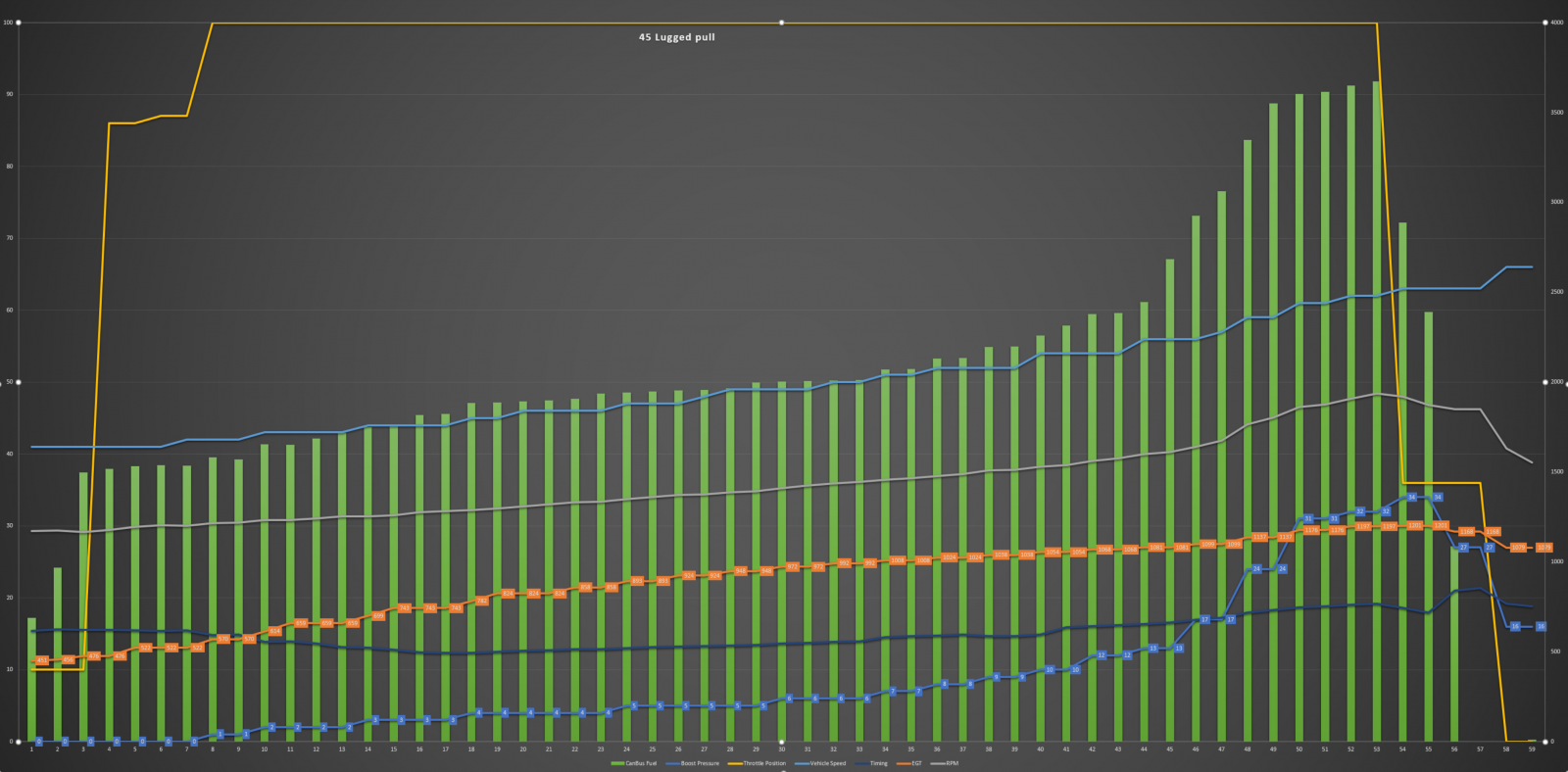

23 hours ago, Dodgeih said:
I have one I just have not looked at it to see if there is any evidence of what happened. I will not have time to stand through it probably for a couple more days. I can attach it and if someone's wanting to look it is right towards the end of the data log. As I'm coasting. I was going about 90 mile an hour before and was coasting to a stop sign when it happened....
surge.csv
I see where it kicks up to about 1/4 load at 0 throttle input right as RPMs drop to idle. Line 4285.  Do you have an oscillating surge when rpms drop to idle after high power runs? Cause I do.

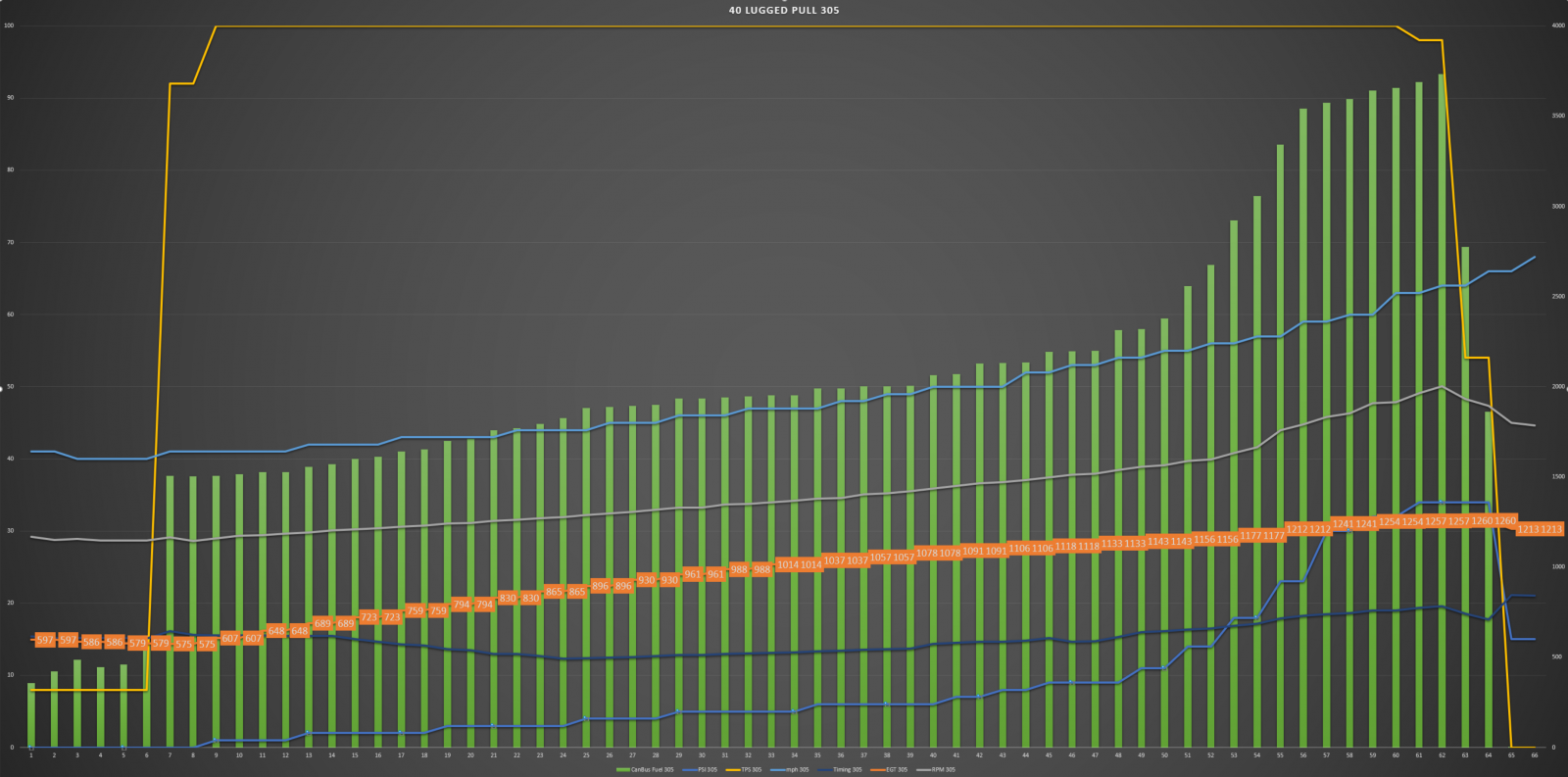

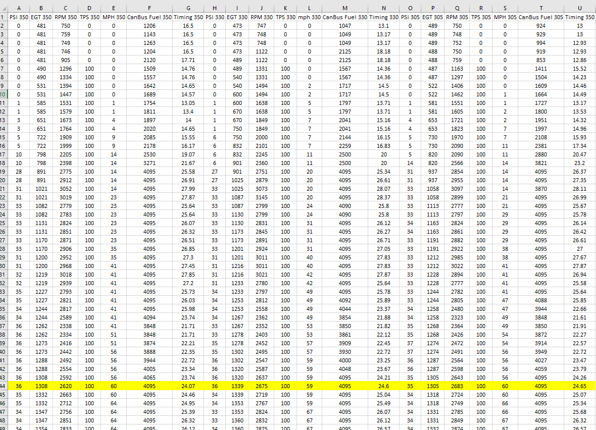

So the injectors are pulled. I'm torn between 315 and 320(settling should be 305 or 310).
Anyone else have any input before going to the shop, I will be this coming Wednesday.
