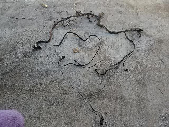

ok folks here it goes....... I found 2 grounds like w-t displayed, including one at the bottom of the ecm that had four 14awg tieed to a 10 awg that deadheads beside the starter on the block the fuel pump +12v is done this way as well as a couple buss sets and and a power set and I redid them all , I removed that big clump of orange wire that was like an extra foot and a half of uselessness, everything was fluxed soldered and heat shrunk to ease my mind.... and that's just the lower engine harness....the upper has only a couple done that way but both are bussing 2 for the +/- buss and two for the can buss protocol . yeah it was a lot of fun best part is I did not repeat not have a single short anywhere anywhen started get kinda pissy at that point. was cruising the web about my dash no bus condition and found two neat things number one is you can initiate a gauge cluster self test by holding in the trip reset and turning key to on position no start then releasing it and it will give you itws own trouble codes and everything....very cool.... and two again whilst bewildered scared and alone I found a true nugget that might save my sorry ***. guy claimed to have same symptoms I do werird codes no pcm coms no buss and dead pedaling issues that act strange he was checking connections and found his power distribution block harness connector ( the one that ties the engine harness to the firewall and power etc ) was NOT ONLY LOSE BUT NASTY HER CLEANED IT UP AND TIGHTENED IT AND BYE BYE CODES AND PROBLEMS ...WELL JUST SO HAPPENS WHEN I WENT TO YANK MINE OFF THE DAM BOLT SPUN FREELY IN MY FINGERS sorry caps lock bomb.... and as an added bonus got the green grimey goo not much but enough and it just happens to be on the buss side on the buss pins and connectors so I am going to walworld for contact cleaner cant get that keg deoxit W-T has so poor boys poor ways ive been gently scarping the female pins to clean them and then back to step hmmmm 8
so this is everything ive done all mods included
step 1 remove lower engine harness, better bring your patience meter and some Tylenol 6 big pain in the keister
          had only two casualties 1 is my lo side ac sensor it was melted to the connector so it got the loraina bobbit
          treatment. 2 the ground behind the starter bolt was froze solid its 10mm and I said $%^%#$%^ and lopped it off
          with a note to repair it
step 2 remove upper harness much mo easier guys, no problems at all
          total time for steps one and two 2.75 hours
          tools needed 10mm wrench and deep and shallows 1/4" drive , needle nose pliers flat blade screwdriver
          13mm 3/8" drive and long handle wratchet  side cutters and a I think 6mm allen wrench for the ecm connector
step 3 clean the harness I first sprayed it with brake kleen and wiped it down then a dose of acetone on a rag
step 4 strip the harnesses this was a lot of fun gently cutting and unwrapping everything and of course pictures for
           refrence took 1 hour and needed two pairs needle nose to spread the harness clamps open and a set of
           front cuts for zipties and a small razor knife
step 5 reclean the harness cause it was nasty........... again acetone and a rag and patience lots of acetone and
           patience
step 6 using a copy of the 3 illistrations for the engine bay harness courtesy of mopar1973man which I spliced together with scissors and tape to make one large continuous map for ease of use I started ohming out every last dam thing total time 3 hours on harness one with notes and 2 hours on upper harness with notes
step 7 lower
          repairswhile I did not find any shorts I did feel the need to fix dodges sloppy handiwork so I repaired thw two
          ground points located just below the ecm split,  the fuel pump buss also below the split and added my custom
          fuel pump feed for my mid frame setup as well to the ground and fuel pump, the big mass of orange wire
          all tied together whicg there is 18" extra nopt needed that got shortened up its listed as a switch supply at the
          ecm I also repaired the ground mess further up near the alternator as well as another power related one
          red with white stripe that was done the same way.
          additions were as follows....a I taped a small blue wire on to the pump 12 v+ supply for the vp44
          which will go to the cab to a 12v led indicator for full time pump power notification and a orange 22awg wire
          to the apps sensor feed which again wikll go to the cab to a test banna point for quik check and monitor
          of my apps voltage via old skool analog meter these both have their own wetpack m/f connector at
          the point the lower ties into the upper and at the firewall where they leave going to the cab.
          upper
          the only repairs made were for the 2 can buss and the 2 buss points done the same way as the others solder
          and heat shrink, then I added my thermos couple feed for my gauge two 22 awg wires, 3 wires for my
          dc amps volts meter setup, 2 wires for the vp44 and apps test points and 4 wires 16awg for switching remotes
          on auxillary systems lights compressor etc, then I stripped and crimped all of my wet pack pins
          made an add on schematic for future refrence on pins and *** embled all my extra connectors together
step 8 tapeing every 8 to 10 " for ease in relooming then adding loom and then taping the harness front to back and at
           at all joints total time about 5 hours  tools solder iron solder sm phillips screwdriver all kinds of crimpers and
           strippers and other soldering based tools
step 9 ohm out new additions time 15 minutes
step 10 apply dielectric grease to all connectors everywhere and crimp on a new ring terminal for the ground
          by starter which I used 10b awg hi strand for that ground
step 11 reattach the harness clamps took about 10 minutes but set them loosely cause theygotta be movable
step 12 will be to install it
now I removed the alternator feed because it was whimpy and I'm wantin hefty plus I'm installing my ripple filter
beta test 001 for further evaluation . I'm installing 2 awg cable on its own route
so that's what ive done so far
