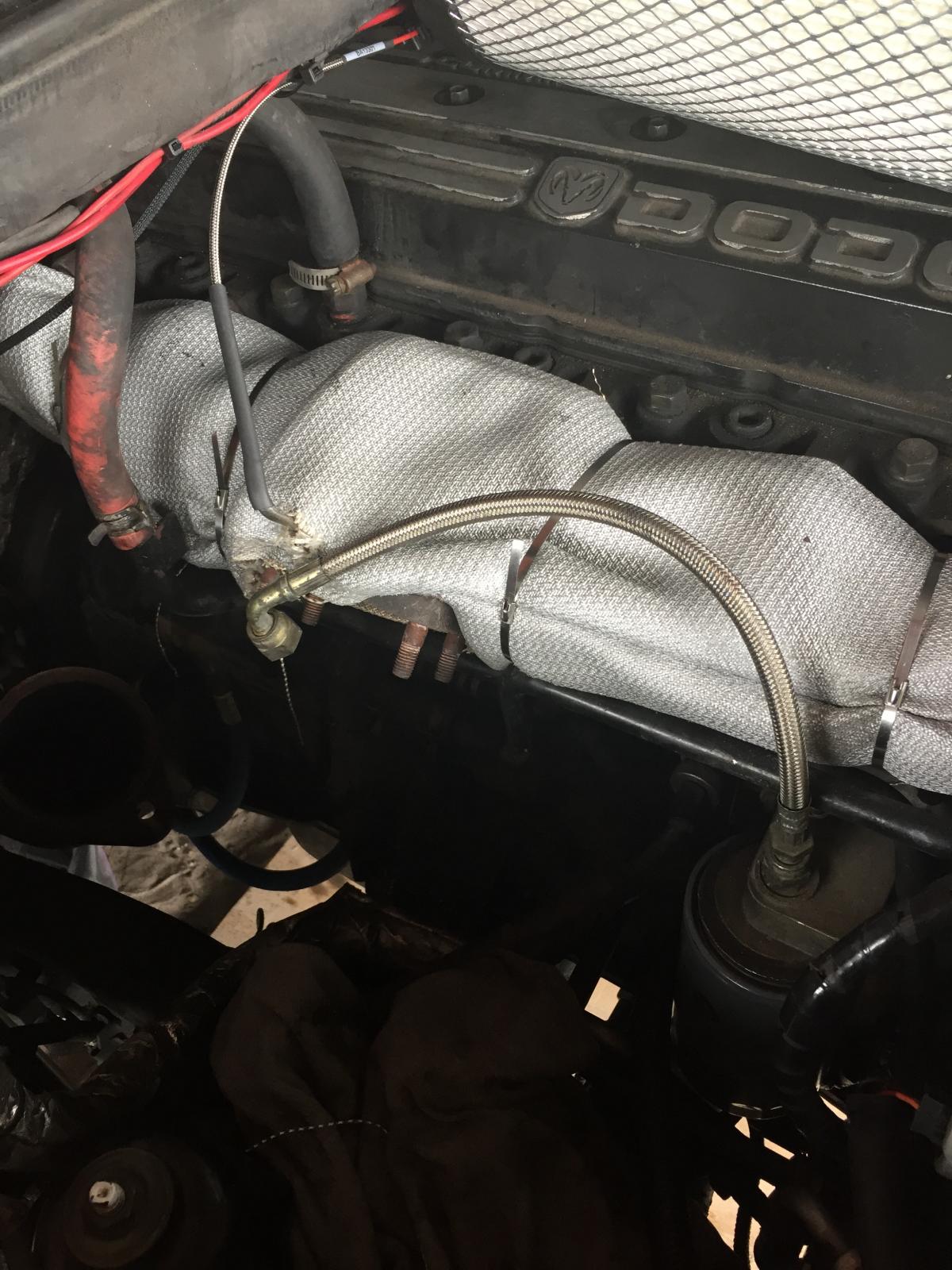

I think the socks are actually more form fitting than the form fitting ones. Form fitting ones will have a larger air space where the side pieces are sewn, whereas the sock will conform all the way around the turbine housing. I was looking at the website you linked and my sock is a much tighter fit than any of the form fit ones they show.

Yes, I need to see what the sock fits like compared to form fit.  Because the formed ones seems to fit the best from what I've seen...:think:
Long story short... A formed fit cover is a box trying to cover a circle. The formed fit ones have hard corners where the pieces meet, this will create an airspace under the seam. The sock covers fit like a sock...tight everywhere.
Would you rather wear a sock or a cloth cube on your feet?
Form fit is only form fitting in name. Look at the photos, they fit loose... end of story. There is nothing in the photos on the link you provided that shows better insulation.
I don't have any photos with me, and I am away from my truck, but consider this.. What hugs your body better... a sock or a boot? A sock, as it conforms to all the shapes of your foot. A boot is already set in its shape and wont conform.
Good point.....but I'm not wearing it. :whistle2:
All joking aside, and I'm not doubting your opinion in any way, but is there actually a negative to how the form fit version fits compared to a sock type which wraps tightly?  Point I think I'm trying to make is, does it matter that there's a gap between the material and the housing or are you speaking from personal choice?  Or is there something gained by having it wrapped tightly?  I guess I'm looking at the blanket as more a heat shield just as I shielded my transmission from the exhaust with a blanket instead of wrap.  Wrap can hold in so much heat that the metal will fatigue, which is why I opted not to go that route.

I am not sure that the heat is an issue as the components are designed to handle the stock EGT's of 1450° from 03+.
I think the benefit to a tighter fitting sock is getting the maximum benefit in turbine efficiency, but I am not sure it's going to provide measurable differences over a looser fitting form fit design.
I only brought it up because you mentioned you wanted a blanket that was as form fitting as possible, which I don't think is the style labeled "form fit" but rather a sock that conforms to turbine better.
I guess it comes down to preference, since as the end of the day they will both improve turbine efficiency and reduce underhood temps.
Point taken..... I guess I'll wait until that one company finishes theirs and then see how it looks.  If its loose and goofy looking then I'll give the sock a try.
That said, whenever you do have the time and want to upload a few pic's, I'd love to see what yours looks like so I have something to base a comparison from.  Thanks. :thumbup2:
