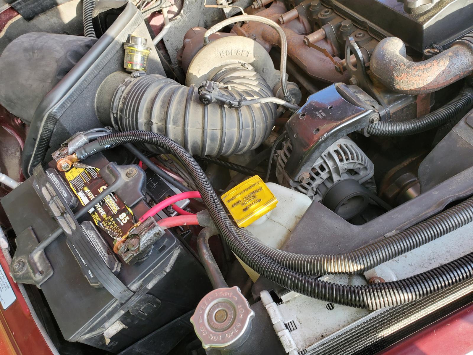

2  Unplug ground wirer, the one (black/yellow) that comes by the alternator, at the aux. battery.
7  Cut the ground wire where the 4 wires are spliced into it and throw the old ground wire in the trash.
I'm finally getting around to taking care of this project but I have a question (please pardon my complete lack of knowledge of anything electrical, it's certainly my weakest area).
As IBMobile listed above: we unplug ground wire from grey plug from aux. battery and cut that wire at the splice near VP44 to make our new ground connection to the gear case.
What have people been doing with the piece of ground wire from the grey plug to the aux. battery negative terminal that is now dangling around doing nothing?

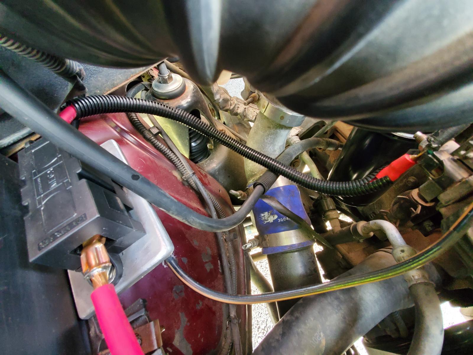

You cut out the part with the 4 small sensor wires that are fused together with some sort of factory clear plastic material with the shrink tube over it. Strip all four of those wires and solder to a single ring terminal and bolt behind the gear case near the VP.
Then using that same heavier cable solder another ring terminal on for the same bolt and run the other end with a lug to the drivers battery.
Now that grey connector just laying there disconnected goes away. It has problems. I had to go out and look at both my trucks negative post on the passenger battery but, one cable from the negative post goes to the alternator case (you can use an alternator case bolt).
Another ground from that same passenger battery post goes to the sheet metal inside the fender near the battery and another ground directly from same post to PCM.
Hope this helps. I just cleans up the whole system, but you will have problems some day if you don't better parallel those two batteries together with the additional cables and lugs needed. Needs to have a total of two + to + cables and two - to - cables to properly parallel. because if the passenger battery ever develops a bad cell it has no temp sensor to limit the alternator from overworking trying to fill a bottomless pit so to speak. It will get the alternator so hot you could short it out and take out the pcm with it.

Yes, Dripley knows me well as I need coffee or I cannot breath...... I would use the grey connector wire for a better ground for the alternator. Just cut off the grey connector and add a ring terminal for grounding the alternator case. W-T recommends that be done and I have read a few articles on the benefits of a seperate ground for the alternator. Grounding thru a rusty bolted bracket has shown some problems.
