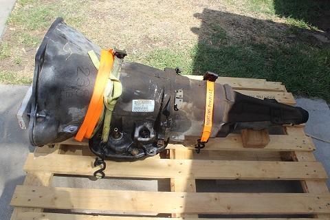

I'll do it again. Normal floor jack and no adapter plates or weird stuff. Just a single ratchet strap. As for getting the transmission off the floor that is easy too. Two ratchet strap and sling it up in the air. Then place your floor jack and use that single ratchet strap to hold on the jack. Raise into position. Best if the truck is flat on the ground.
Even got a board rigged for even G56 transmissions. Auto or manual you can do single ratchet strap.

Always best to remove the transfer case first then the transmission next. If you don't have the room. Sling the transmission up on the frame rails and then lower it down slowly to the floor. Then you can slide it out.

That might be the best thing for a manual since it has to go back before it goes down.  I think an auto is actually a little easier.  If you don't have a device to spread the frame then you must remove the transfer case first so you can slide the crossmember back and out.  But if you can spread the frame to remove the crossmember and have a capable transmission jack then the tranny and transfer case can be pulled as one unit and then seperated on the ground.  That's how I did it anyways.  I did put them back in separately however.
