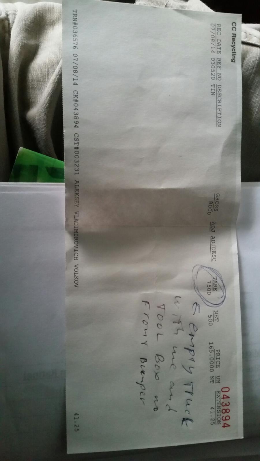

Here is mine before I made front bumper that added another 150lb probably
It is a scrap yard so not sure how accurate
I was 7360 a month ago with a full tank of fuel and me in it
