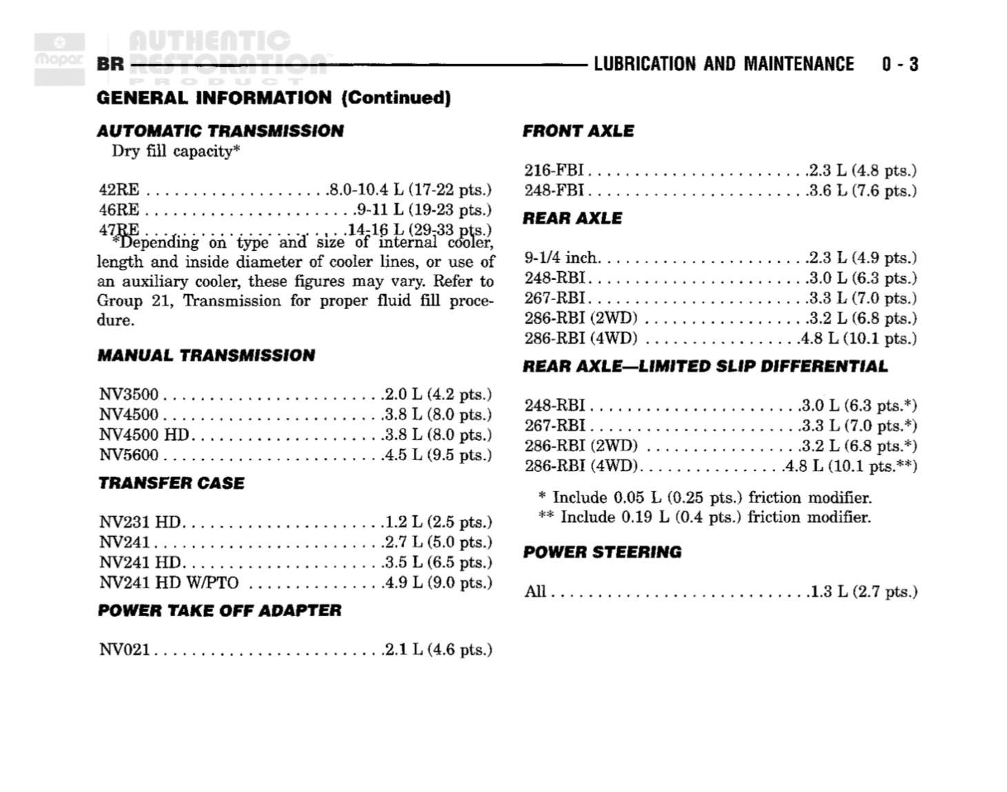

3.2L which includes 0.05L of friction modifier   :thumbup2:

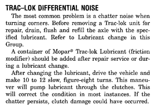

Also, please note that last paragraph...
