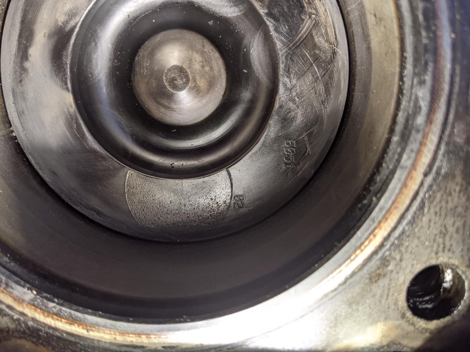

  • That doesn't look like a dropped valve ..... way too little damage, If it had dropped a valve properly the top of piston would look like WW3, I'd say  it's been over revved as those marks are just kis

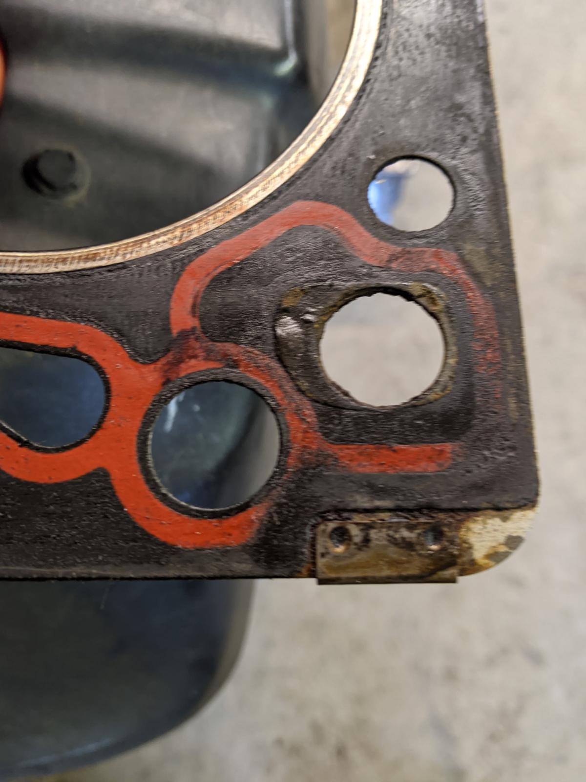

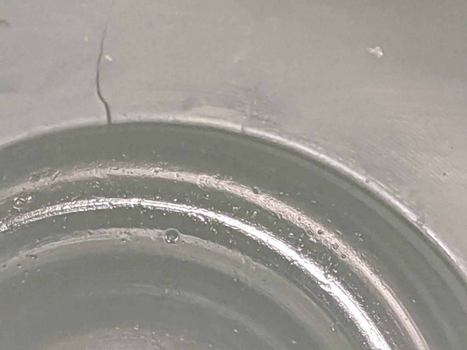

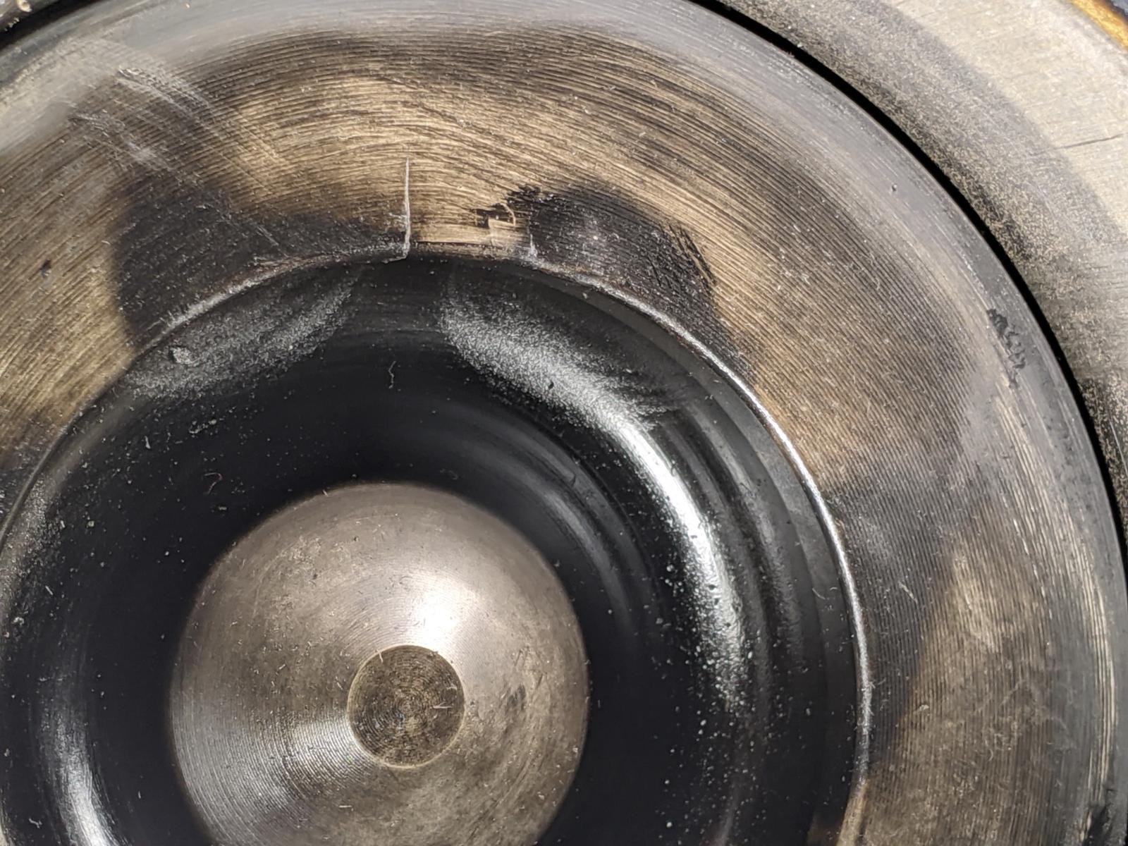

I will take my head in tomorrow and get it checked out, I had a small coolant leak at the back of my head, driver's side. I was attempting to get everything lined up in preparation for the worse case scenario, cracked headPXL_20210317_232101145.jpg.329b3d887c7c0d88190f075099821c02.jpg.... That's why the questions. What I also found was cracked pistons on 1,2,3 and 5, along with hit marks from the intake valves on top of the pistons on 2 and 5. The last picture was my coolant leak, head gasket failed... Also I should have mentioned that the parts list is from DAP.

Dripley, I don't think I posted about a cracked head but I did post a head leak issue a bit a month or so ago. That problem was a sensor had been screwed into the 3/4 npt port in the back of the head and was leaking coolant from it. I replaced it with a npt plug and fixed that problem. Just to discover a leak on #6 connector tube, got that fixed, new tubes and discovered a leak at the head gasket, driver's side all the way aft. That's why I removed the head, just to find cracked pistons and valve contact. I should have shot this truck with a 50 cal. round months ago. While that doesn't fix anything it would have put a grin on my face.
That doesn't look like a dropped valve ..... way too little damage, If it had dropped a valve properly the top of piston would look like WW3, I'd say  it's been over revved as those marks are just kiss marks.
Or a sticking valve due to it getting hot
Or someone made a right mess of doing the tappets and got one/some way too tight
Or  valve lash was that much a pushrod ended up on the edge of the rocker instead of in it's place
Or someone rebuilt the timing gears and got it a tooth out
Anything that reduced the piston to valve clearance by just enough for contact but not total destruction

Silverwolf, I will look into Cummins OEM rebuild kit. I don't know the history of this truck, obviously abused though. Bought it not running. Two pistons were tapped by intake valves and 4 pistons have cracks. The bores look good and measure out at 4.015 diameter, still see cross hatch marks in bores. I've run the truck 3500 miles and can still read the dip stick through the oil and no blow by or wind in the basement!!! I will lift the engine out in the morning and disassemble it to see what needs to be ordered. The head measured at the low limit 4.125 thickness. So it has been surfaced a couple of times? New head time @ 208K miles. I will get her back up and running again.
Most likely the connecting rod bearing are washed out. I've seen one other that managed to leave valve impressions in the pistons.
I was thinking someone was sled pulling and floated valves and overheated the engine :think::shrug: guess doesn't matter now, good luck in rebuilt. Waiting on more pictures.
