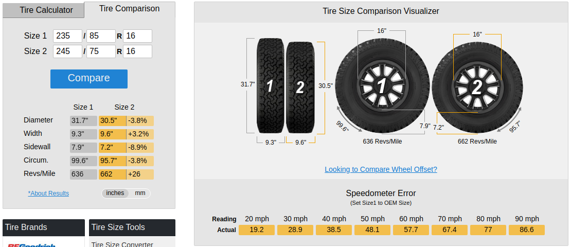

Just in the 120 miles I'm loving 245's over my 235's. Very impressed with the changes. Now I'm having hard time understanding people with 35 or 37 inch tires with 3.55 gears. I'm going to start fuel logs on my next tank.

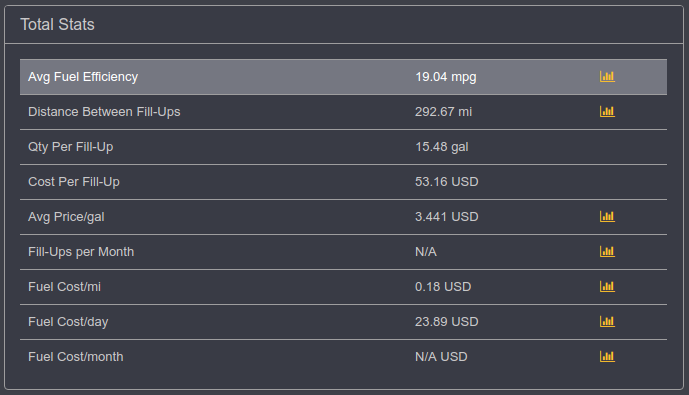

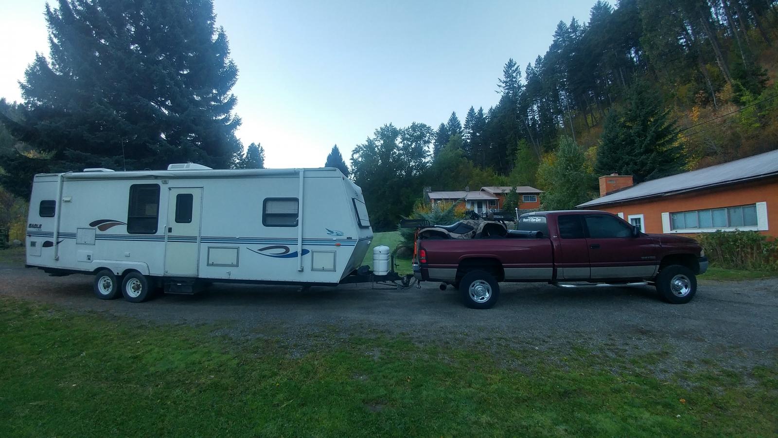

I too had 265/75R-16 tires and came across a deal for five 245/75R-16 That I switched to the smaller size.   I too drive at 65MPH or less and tow 90% of the time.  In the last 9 months the truck has towed over 12.000 with only seeing exhaust temp increases going up steep grades like route 16 out of Rapid City, SD up into the Black Hills.  I just took it out of overdrive and backed off a hair.
Just about mustered 21 MPG on the last tank.

I just made a run at 80 MPH down a short blast of the interstate. 245's on the rear yet. In 5th gear at 80 MPH it's turning 2,400 RPM. not bad yet you can safely blow down the interstate at 70 MPH and still but reasonable like 2200 RPM (IIRC). I know previously 70 MPH was a touch over 2,100 RPM.
@dripley Basically the RPM difference if you drive 5 MPH faster that is what you new RPM will be. So if you want to see 70 MPH on 245's drive 75 MPH that is your RPM at 70 MPH on 245's.
