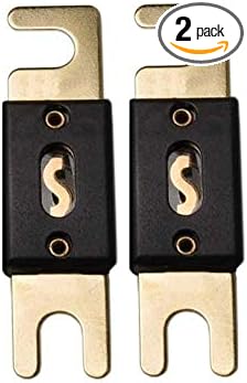

Yup exactly. Hence why my landlords truck blew the 150 Amp alternator fuse I installed while running his winch. Even though the alternator is only 136 Amp. As the batteries dropped in voltage being totally wore out it increase the current from a already tapped out alternator and blew the fuse out. Again batteries have more of the role of "storage of energy" to be redelivered to the electrical loads. Alternator is only to recharge the batteries NOT to sustain high loads. Being like myself got two WalMart batteries at 810 CCA that is 1,620 CCA if that can't sustain a winch for a time of pulling then I would say batteries are not doing there job. Even stock was 750 CCA for 1,500 CCA total.
 ANL Fuse 150A 150 Amp For Car Vehicle Marine Audio Video System Gold 2 Pack (150 Amp)
Yup, Even with 136 Amp stock alternator and weak batteries you can blow a 150 Amp fuse or circuit breaker. Just because the batteries are weak or no longer have the capacity for said loads. Again like even the rebuilder down in Nampa, ID told me the alternators are not to blame but weak connections, bad grounds, and weak batteries.
