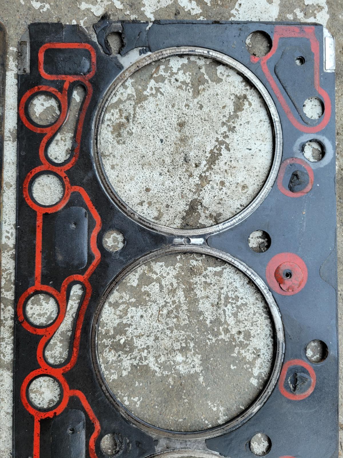

So here we go... Take notice ot the missing chunk of gasket above the tear. That is is steel plate in that gap. No, its not suppose to separate like that.

    Well I got the head gasket install yesterday. Still got a bit of fuel system to put back yet.    The gasket fell apart in a bout 4 different places. coolant jackets down the passenger side b

The gasket fell apart in a bout 4 different places. coolant jackets down the passenger side blistered up. Between cylinder the gasket came apart better cylinders. Then the big part of it around the bolt in the front. I even called back to DAP to verify the manufacture and was told its a Cummins OEM gasket. All them look exactly the same for material and design.

My answer is NO. Being Cummins does not produce head gaskets. After seeing this failure I would absolutely say no. Cummins head gasket is produced by BLK (Not Cummins). Both gaskets are Cummins OE, but again not produced by Cummins.
The defective gasket... Look the amount of de-lamination.
This pic is where the coolant passage blew out. That whole corner gave up and the composite material lifted.
Now my old head gasket before when the oil was blowing out the front. The one on the left as you can see did not seperate and still intact. Compared to the right which is also a Cummins OE gasket.

I use Napa/Fel-Pro. That gasket has a serious imprint of the head clamp. What are you torqueing the studs to?
Fine threads require less torque to develop equivalent bolt preloads v/s coarse thread.

Really simple. Like I've said all a long that just because it says Cummins does NOT make it quality. Cummins been and always will change providers when they an make a better dollar. I've already proven the Cummins thermostat and now the Cummins head gasket.
