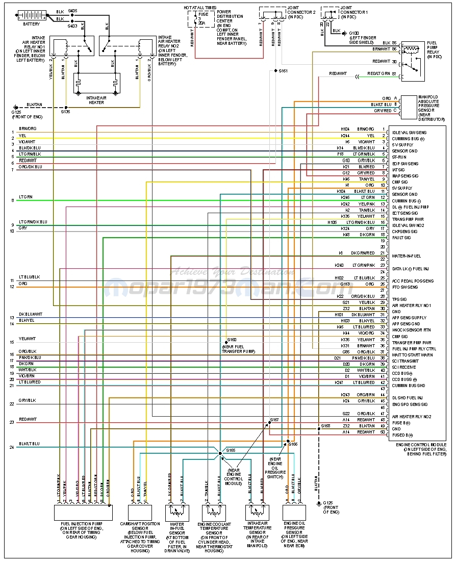

Fairly simple really. The fuel pump relay in the PDC is the power relay for the VP44. If you open the PDC up you can see the black ground lead for the relay. Just wire it into the cab on a SPST switch and mount the switch in a good hiding spot that isn't obvious. A single wire is really easy to tuck back in the main loom so there is no clue that that is the kill lead. The big trick is to mount the kill switch some where you can toggle without a passenger or other people looking can see you reach for. Like around your driver seat base maybe?
Not good enough. A third could use another relay like the horn to still start it. This why you need to make it harder to figure out. Missing relay is easy like pulling a fuse. What happens when everything is in place? Now the thief will more likely move on after he cleans out the cab like you ScanGauge.
Again it needs to wire to complete the signal. Remember mine is only one wire looking for a ground path. It will crank till the battery is dead because the VP44 is not powered up. Single wire is really easy to hide where 2 wire of heavier gauge will be a bit tricky.
