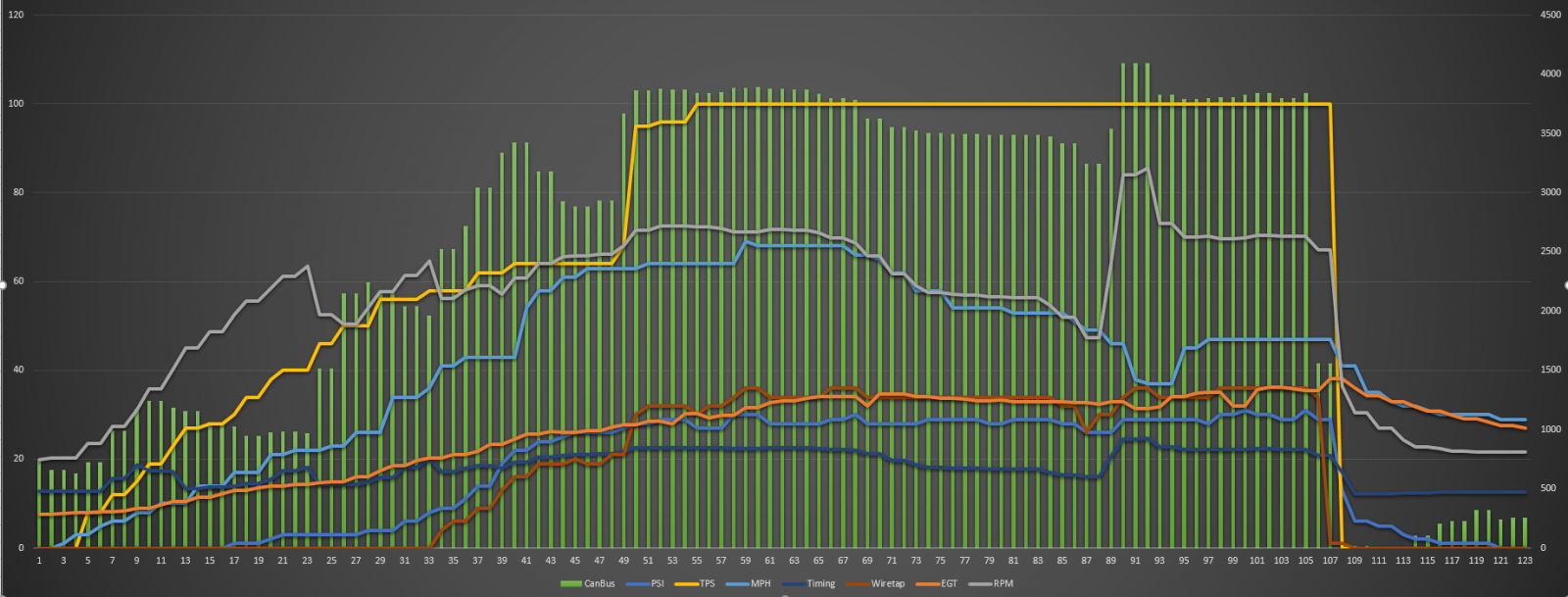

Well it passed with flying colors today.  Not as much power as I wanted, but from the datalog I could have thrown a bunch more fuel at the truck.  I wasn't exactly sure how they did the run so my tune wasn't setup right for what they actually did.
Here's the run.  The way they do it is take her up to 65 ish mph then increase the load on the dyno until rpms fall.  they mark opacity at 60, 50 and 40 mph.
Full data log
You can see how canbus doesn't stay at max, This run ended up being about stock fueling duration + ~%30 wiretap ~540 uS .  On the street this tune does max duration + %50 wiretap  Guessing about a ~50 hp difference between the lug down dyno and street.

Line 73 of the datalog is the 60 mph reading (85 % duration), line 87 is the 50 mph (%78 duration), line 92 is 40( %100 duration, but it looks like they recorded the power mid downshift).  The guy says stock 2nd gens typically put down ~160 hp on during this test.
