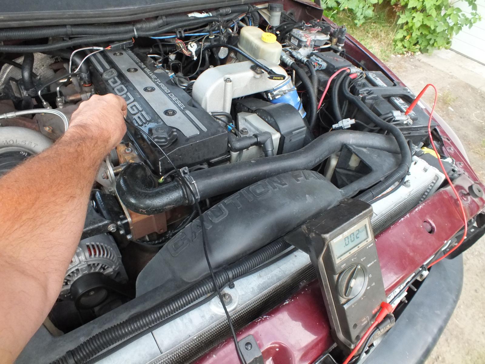

You cut the one wire that comes from the other side for the other computer grounds that you ground to the timing gear case and get rid of that wire. Or you could just cut the Y out and solder enough wire to reach the passenger (aulilary) battery negative terminal. Right Mr @IBMobile or @W-T?
This is what I deciphered from W-T's post also.
22 hours ago, Dodgeih said:
So... Trying to follow... Here's what i got in my head.... The alternator wire is pulled out of the loom and now connected to passenger battery. Then the ground is pulled out of the loom and the group of grounds is connected under vp with a jumper to drivers battery? Sorry lots of info that is slightly over my head so trying to follow along
That's why I asked for a basic simplification of exactly what W-T actually re-wired
Edited by GSP7
5 hours ago, Dodgeih said:
Then do you just hook up the ground that runs back behind the air cleaner back up to the battery on the passenger side? Since that ground splits into a y
The ground wire that comes from the auxiliary battery negative post clamp and splits in a Y has a connector at the end of each 'leg of the Y'.
One leg connected to the ground wire that ran by the alternator, in front of the engine and to the point where the 4 wires spliced on to it.  This wire is unplugged from the connector by the auxiliary battery, cut of at the point where the 4 smaller ground wires join it on the left side of the engine and thrown away.
The other wire that runs by the air cleaner is the ground for the PCM.  This wire run is 2-#14 black/yellow wires from PCM spliced to a #10 black/yellow wire to a connector.  This connector joins the other leg of the Y which is spliced to the #8 wire at the auxiliary battery negative clamp.
It can be either left plugged into the other leg of the Y connector or you can cut out the connector and Y splice at the battery.  Now find where the 2 #14 AWG  grounds for the PCM splice into the #10 AWG and cut out the #10 wire.   You can now solder the 2 #14 grounds to a new length of #8 AWG and the other end to the #8 at the aux. battery.
  • Thanks 1
The ground wire that runs back to the PCM goes thru a y splice then a plugin joint connector and to one more splice that is necessary. I woul go back to that splice with a new wire, no splices or joints, for a cleaner connection to the batterry.
 You would not have to do this. You can just leave the wire as is and tape the y splice after you cut the other ground, from the drivers side, loose.
Technically the best design would of been come out of each device and ground right there next to the device. I know the VP44 has that nice threaded hole next to it that @W-T used. Now the ECM has the ground for the lift pump and fuel heater behind the starter right close to the ECM. The PCM you would have to go to the other end of the ground strap. That would cover the 3 main computers.
