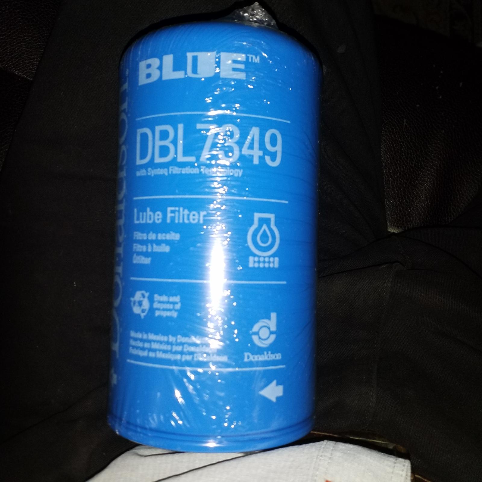

Regarding cost of oil, in my travels to northern Iowa and Minnesota I have found T6 to occasionally be on sale. Coupled with the Shell $7/gallon rebate they ran last year I got T6 for $2.25 per quart when purchased in 10 qt. jugs!
Coupled with the Donaldson filter my oil analysis (including TBN) came back great at 10k miles, so I stick to that - it's also about the time I need to add more oil, so I change it. I put my oil sampling port on the filter housing so that may affect the grading of my engine's health, but that is THE oil going to my engine!
